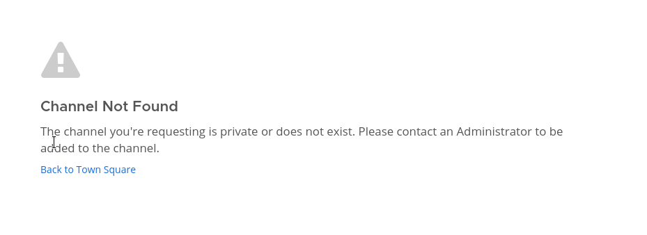

When I try to access anything that is not the system console, I get the error page “Channel is private or does not exist. "

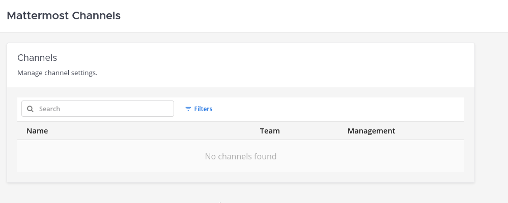

Checking in the system console web UI under channels, the list is empty.

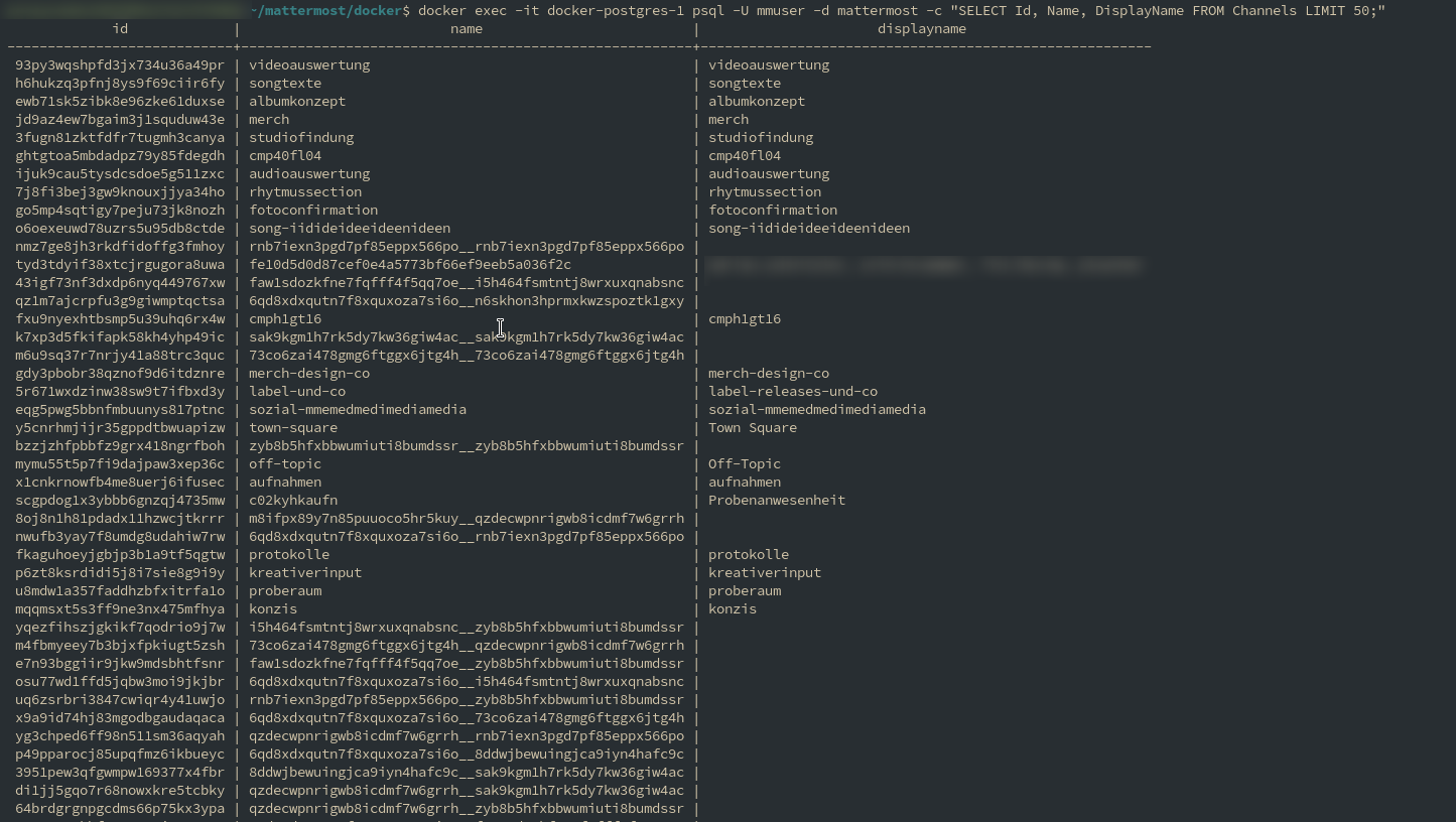

I check the DB, there are channels listed.
