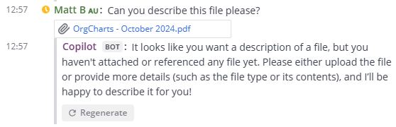

Hi, I have observed this behaviour on our test machine - the agent is quite happy with .docx files but won’t process PDF (confirmed the PDF files are not image only files). I haven’t had time to further investigate this as yet. If anyone has any idea about this I would be interested to know!
I was able to reproduce the same behaviour in our test container. Looks like since 10.6.1 version processing of the attached files is bugged / broken. I’ve also observed the same behaviour for 10.9.0 and 10.9.2 versions
I notice the Agents plug in is now V1.2.1, I assume the problem still exists? I’ve seen reports where all attached files are broken, in my limited experience it seems PDF only…

Word (docx) and JPG/PNG files are able to be read through the plugin. Excel and PDF files do not seem to be accepted. This is using OpenAI gpt-4.1.

Hey all. I think this issue should be resolved in the latest version of the plugin. I was also reported here: 🐛 bug: Mattermost doesn't read attached files in a conversation with AI Agent · Issue #352 · mattermost/mattermost-plugin-agents · GitHub
This feature relies on the Mattermost server to extract text from PDFs and other file attachments. This also powers the ability to search though the content of same documents, so a good way to test if it’s the Agents plugin or the server having an issue is to do a search for content within those documents and see if your PDFs or other documents show up or not.
Also note that not all documents types are supported, Agents supports the same ones that the server supports. Documentation for which are supported is available here: Search for messages - Mattermost documentation
Note that the pdftotext utility needs to be functional on the MM server.
