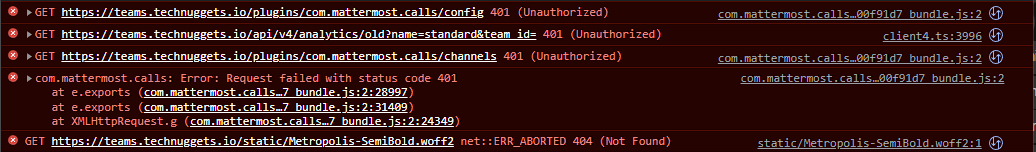

I’ve been doing some recon and noticed some 401 errors in the console:
The first four lines are just from the calls plugin - do you use Mattermost calls? You could try to disable it temporarily and check if this changes something with regards to the startup time.
The last line just says that a font is missing (this font is also missing on my setup, so it might not be one of the default options and maybe unrelated).
