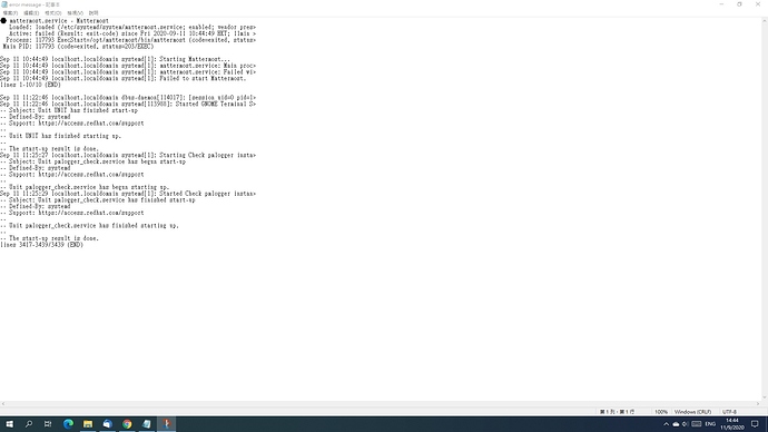

Hi, @Ada
Thanks for the update. The exit code (203) suggests the service failed to find the executable to run. Can you please confirm that /opt/mattermost/bin/mattermost actually exists?
Additionally, can you get the journalctl -u mattermost -f to show the last entries only for Mattermost?
Also, run the sestatus command as well and share the output. Thanks.
The /opt/mattermost/bin/mattermost is actually exists. Please refer to the attachment.
The result of journalctl -u mattermost -f to show the last entries only for Mattermost as follow:

I have tried the way which you provide to me to solve the problem, yet it cannot be successful. Please refer to below output:
[root@localhost ~]# sudo setenforce
usage: setenforce [ Enforcing | Permissive | 1 | 0 ]
[root@localhost ~]# sudo systemctl start mattermost
Job for mattermost.service failed because the control process exited with error code.
See “systemctl status mattermost.service” and “journalctl -xe” for details.
[root@localhost ~]# sudo systemctl status mattermost
● mattermost.service - Mattermost
Loaded: loaded (/etc/systemd/system/mattermost.service; enabled; vendor pres>
Active: failed (Result: exit-code) since Wed 2020-09-16 10:32:35 HKT; 39s ago
Process: 833872 ExecStart=/opt/mattermost/bin/mattermost (code=exited, status>
Main PID: 833872 (code=exited, status=203/EXEC)
Sep 16 10:32:35 localhost.localdomain systemd[1]: Starting Mattermost…
Sep 16 10:32:35 localhost.localdomain systemd[1]: mattermost.service: Main proc>
Sep 16 10:32:35 localhost.localdomain systemd[1]: mattermost.service: Failed wi>
Sep 16 10:32:35 localhost.localdomain systemd[1]: Failed to start Mattermost.
lines 1-10/10 (END)

Below is the output of systemctl status mattermost.service:
Loaded: loaded (/etc/systemd/system/mattermost.service; enabled; vendor preset: disabled)
Active: failed (Result: exit-code) since Thu 2020-09-17 16:05:28 HKT; 46min ago
Process: 1014897 ExecStart=/opt/mattermost/bin/mattermost (code=exited, status=1/FAILURE)
Main PID: 1014897 (code=exited, status=1/FAILURE)
Sep 17 16:05:28 localhost.localdomain mattermost[1014897]: version Display version information
Sep 17 16:05:28 localhost.localdomain mattermost[1014897]: webhook Management of webhooks
Sep 17 16:05:28 localhost.localdomain mattermost[1014897]: Flags:
Sep 17 16:05:28 localhost.localdomain mattermost[1014897]: -c, --config string Configuration file to use. (default “config.json”)
Sep 17 16:05:28 localhost.localdomain mattermost[1014897]: --disableconfigwatch When set config.json will not be loaded from disk when the file is changed.
Sep 17 16:05:28 localhost.localdomain mattermost[1014897]: -h, --help help for mattermost
Sep 17 16:05:28 localhost.localdomain mattermost[1014897]: Use “mattermost [command] --help” for more information about a command.
Sep 17 16:05:28 localhost.localdomain systemd[1]: mattermost.service: Main process exited, code=exited, status=1/FAILURE
Sep 17 16:05:28 localhost.localdomain systemd[1]: mattermost.service: Failed with result ‘exit-code’.
Sep 17 16:05:28 localhost.localdomain systemd[1]: Failed to start Mattermost.
lines 1-16/16 (END)
