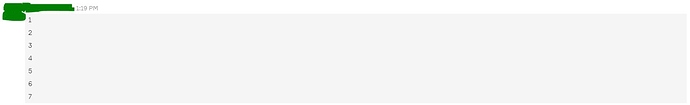

Hello all.
I have a stand with two servers running. They’ve got two Mattermosts running on them. Both servers have the same configuration for both Nginx and Mattermost and other services.
When I send a chat message in a web application to a mobile application or vice versa, I only receive half of the messages - the other half just does not come via WSS but comes via HTTPS - I see the missing messages after refreshing the page. And I didn’t see any errors in the logs about it.
With all this, the problem is eliminated when I disable MM on the second server.
What are the reasons for WSS malfunctioning and how can I fix them? (Disabling MM on the second server doesn’t suit me).
Thanks.
