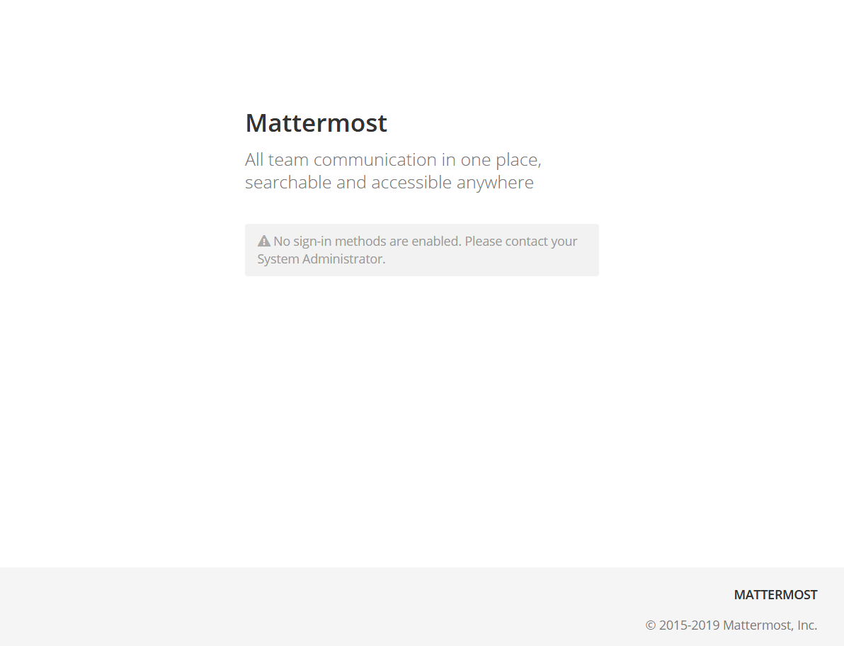

After installing Mattermost I get the error message: “No sign-in methods are enabled.”
Steps to reproduce
We have installed:
Version: 5.5.0
Build Number: 5.5.1
Build Date: Thu Dec  6 09:21:58 UTC 2018
Build Hash: 826252252404c13bf564a8c4fd51616fc2cc4df9
Build Enterprise Ready: true
DB Version: 5.5.0
And we have configured the Apache2 setup:
https://docs.mattermost.com/install/config-apache2.html#
Expected behavior
I expect, that I get any kind of login dialog.
Observed behavior
This is all I get:
Screenshot-2019-1-10%20undefined
The problem seems to be triggered by setting ServiceSettings.SiteURL. When I leave the setting empty, I get a HTML page, when I run curl http://localhost:8065. But when I set the parameter, I get just:
# curl http://localhost:8065
<a href="/mattermost">Found</a>.
Is this the intended behaviour?

The problem seems to be the Apache configuration. The Mattermost documentation explains how to pass all requests to a Mattermost server:
<VirtualHost *:80>
  # If you're not using a subdomain you may need to set a ServerAlias to:
  # ServerAlias www.mydomain.com
  ServerName mysubdomain.mydomain.com
  ServerAdmin hostmaster@mydomain.com
  ProxyPreserveHost On
  # Set web sockets
  RewriteEngine On
  RewriteCond %{REQUEST_URI} /api/v[0-9]+/(users/)?websocket [NC,OR]
  RewriteCond %{HTTP:UPGRADE} ^WebSocket$ [NC,OR]
  RewriteCond %{HTTP:CONNECTION} ^Upgrade$ [NC]
  RewriteRule .* ws://127.0.0.1:8065%{REQUEST_URI} [P,QSA,L]
  <Location />
        Require all granted
        ProxyPass http://127.0.0.1:8065/
        ProxyPassReverse http://127.0.0.1:8065/
        ProxyPassReverseCookieDomain 127.0.0.1 mysubdomain.mydomain.com
  </Location>
</VirtualHost>
But this does not match our setup. We want to pass the traffic to three different processes.
/jira to localhost:8080/jira
/confluence to localhost:8090/confluence
/mattermost to localhost:8065/mattermost
Our problem is, that we are not sure how to rewrite the Apache configuration to achieve this.
This configuration solved the problem:
  RewriteEngine On
  RewriteCond %{REQUEST_URI}      /mattermost/api/v[0-9]+/(users/)?websocket [NC,OR]
  RewriteRule "^(/mattermost/.*)" ws://localhost:8065%{REQUEST_URI} [P,QSA,L]
  <Location /mattermost>
    Require                      all granted
    ProxyPass                    http://localhost:8065/mattermost
    ProxyPassReverse             http://localhost:8065/mattermost
    ProxyPassReverseCookieDomain localhost fqdn
  </Location>
