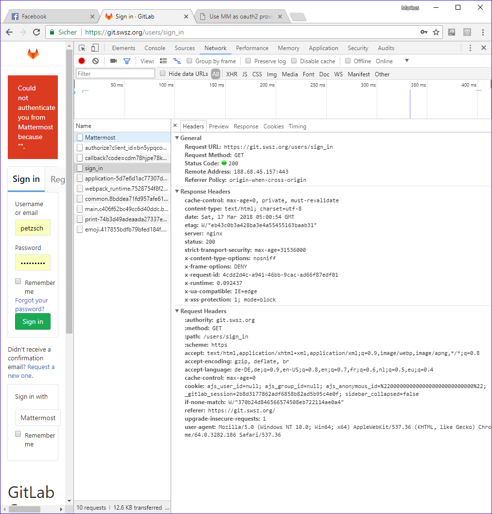

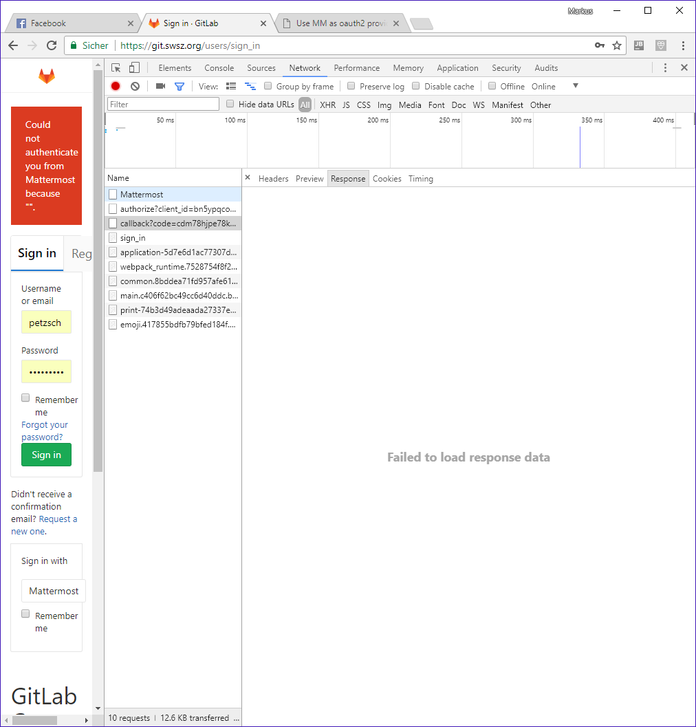

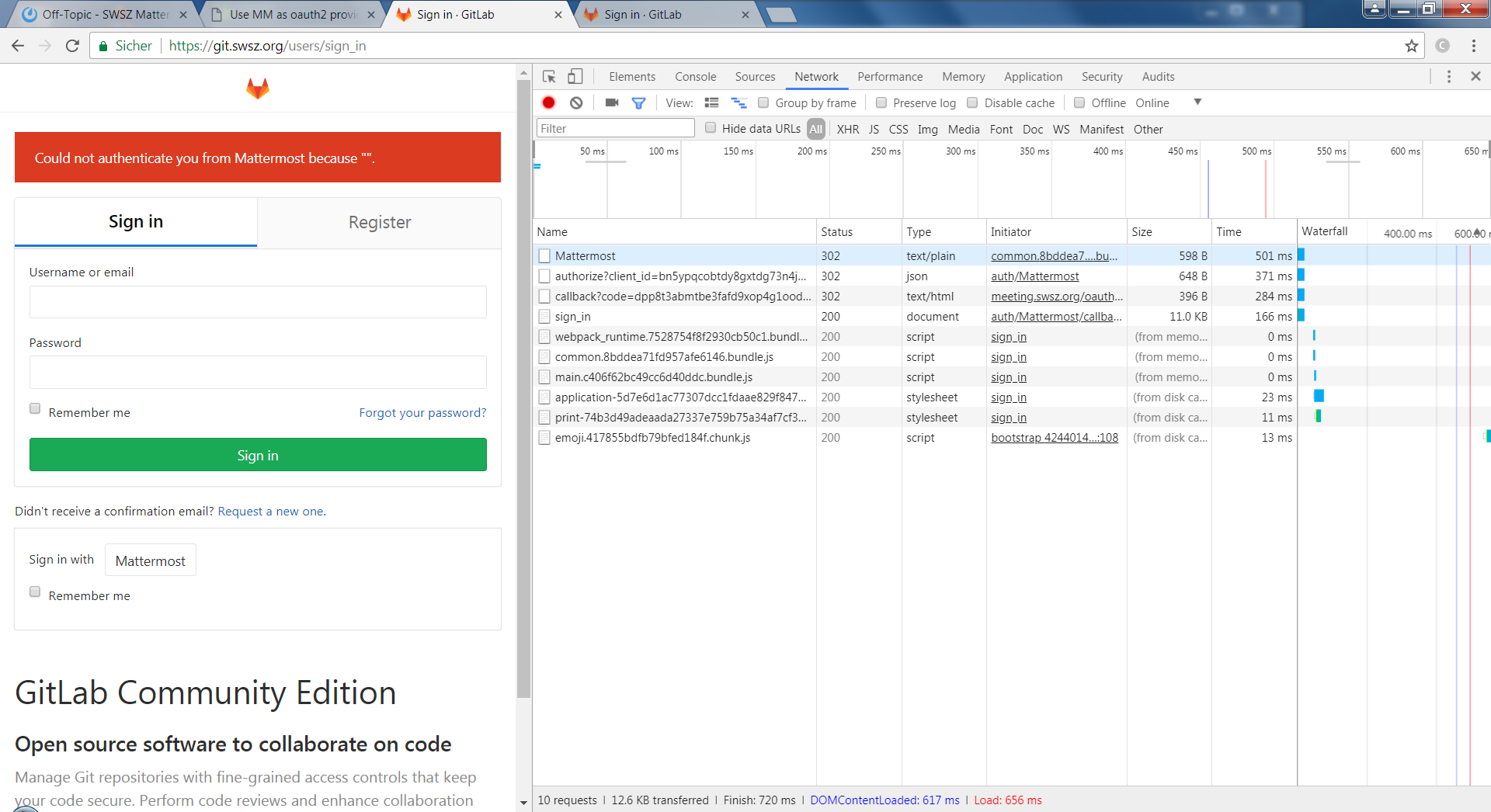

In that console tab, can you consecutively click on the top four network requests and post the Form Data from the bottom of the Headers tab, and the entire contents of the Response tab? (Shouldn’t be anything to redact from that text, but may want to just peruse before posting publicly.)
Here are the requested screens: (can only post one image per post)
I’ve now deauthorized the app, just that the oauth tokens posted here can’t be reused.
Kind of strange that the response tab is always empty.
