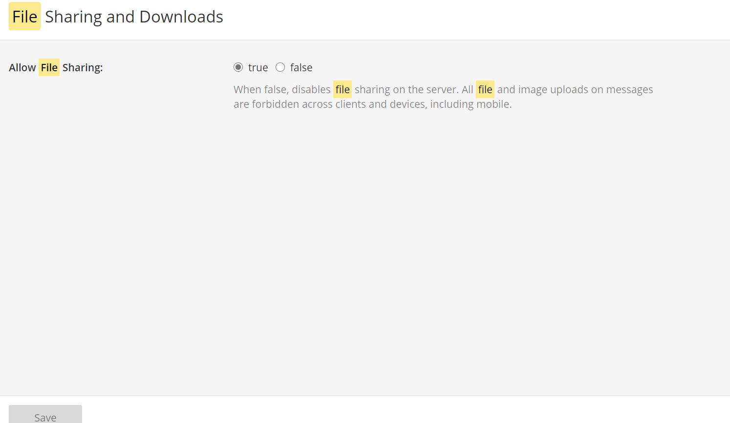

Thanks a lot @amy.blais for your solution ! I checked the option to disallow downloading files in the mobile app , I could not see the option in system console (Please see screenshot attached), we are using older version of Mattermost Server (5.22.2) .
, Is there any other way to disable file downloads for mobile apps .
Best Regards ,
Rohan
Allow File Uploads on Mobile setting is available in E20.
Allow File Sharing is available for all Editions and if you disable it, then all file uploads are disabled.
