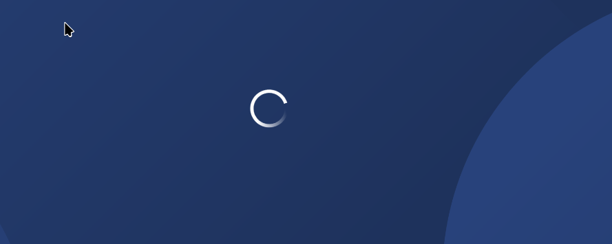

After upgrading from version 9 to version 10, it is no longer possible to use the server or log in.
I have tested different 10.x versions and it is always the same behavior.
When I open the page with a browser with which I am logged in, I only see the loading symbol.

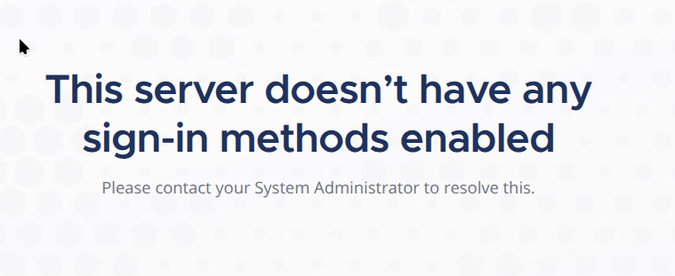

If I open the page with a browser with which I am not logged in, the message appears:

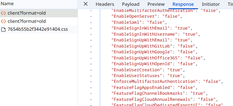

However, logging in with username or e-mail is activated and is also sent correctly to the browser:

After a lot of research and testing, we found out what the problem was. Our nginx delivered the JSON data with the content type application/json; charset=utf-8. After we removed the charset, everything worked.
