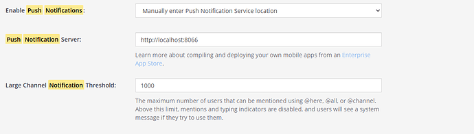

Hi!
It still shows the same error on my end even if I configured everything. I setup the push notification server on the same server and put the url as localhost.
I would appreciate really if you can help me.
