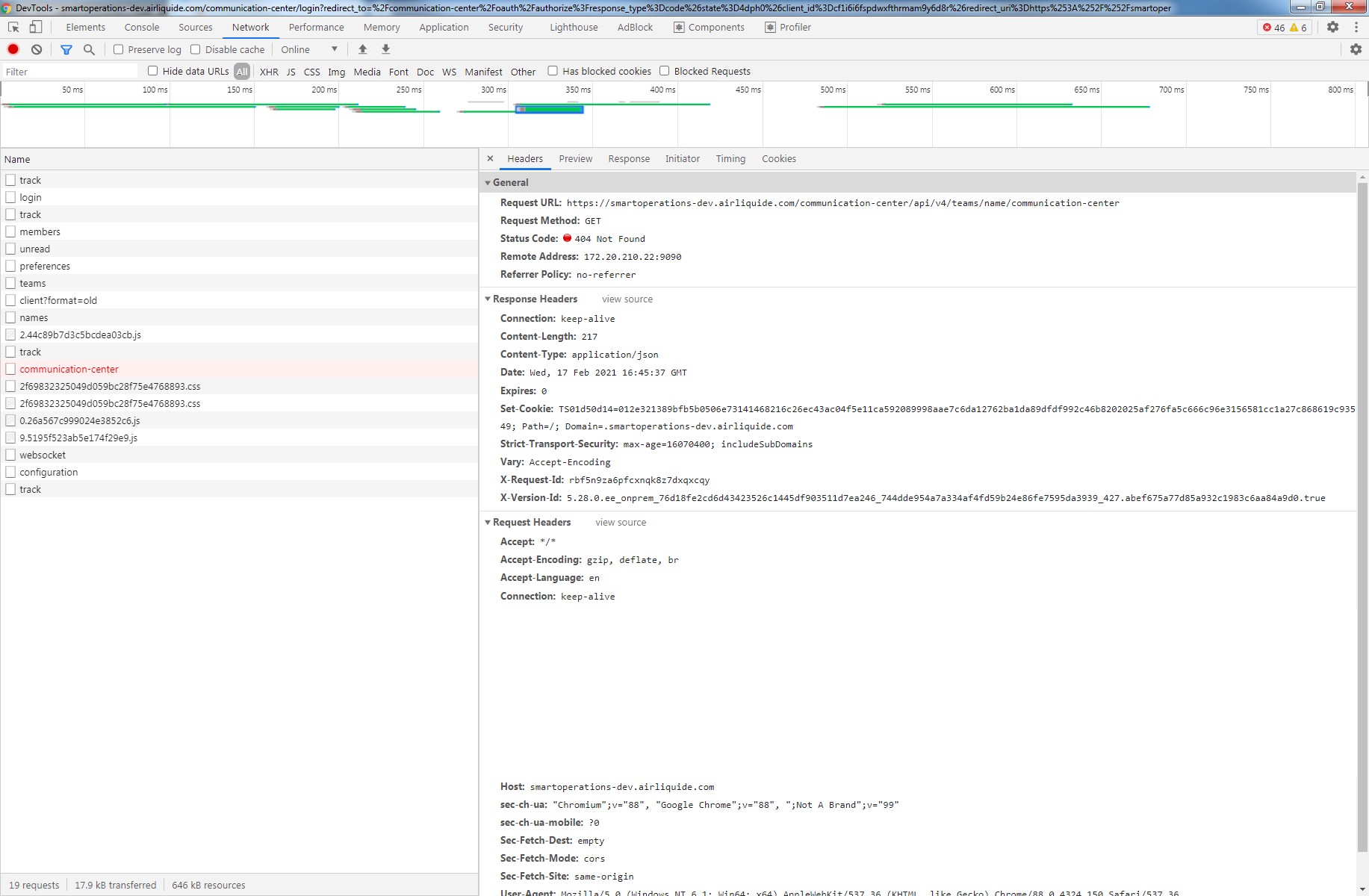

My team is using Mattermost as an OAuth2.0 Service Provider in an Angular webapp. The Mattermost instance is configured to use both a username/password login and a Google SSO login.
During the OAuth2.0 login process, the users logging in with Google are logged in correctly, and redirected correctly to the Angular app. Users logging in with username/password, however, are met with a “Team not found” error (see screenshot).

However, the JS console has an error I didn’t see before due to having “Preserve Logs” unchecked :
main.23eccd40255a70458645.js:763 GET https://.com/communication-center/api/v4/teams/name/communication-center 404 (Not Found)
It seems Mattermost views the path at which the Mattermost instance is hosted (/communication-center) as a team name.

As a complement, this is only happening when I connect with a GUEST account and that should be noted to reproduce this bug.
