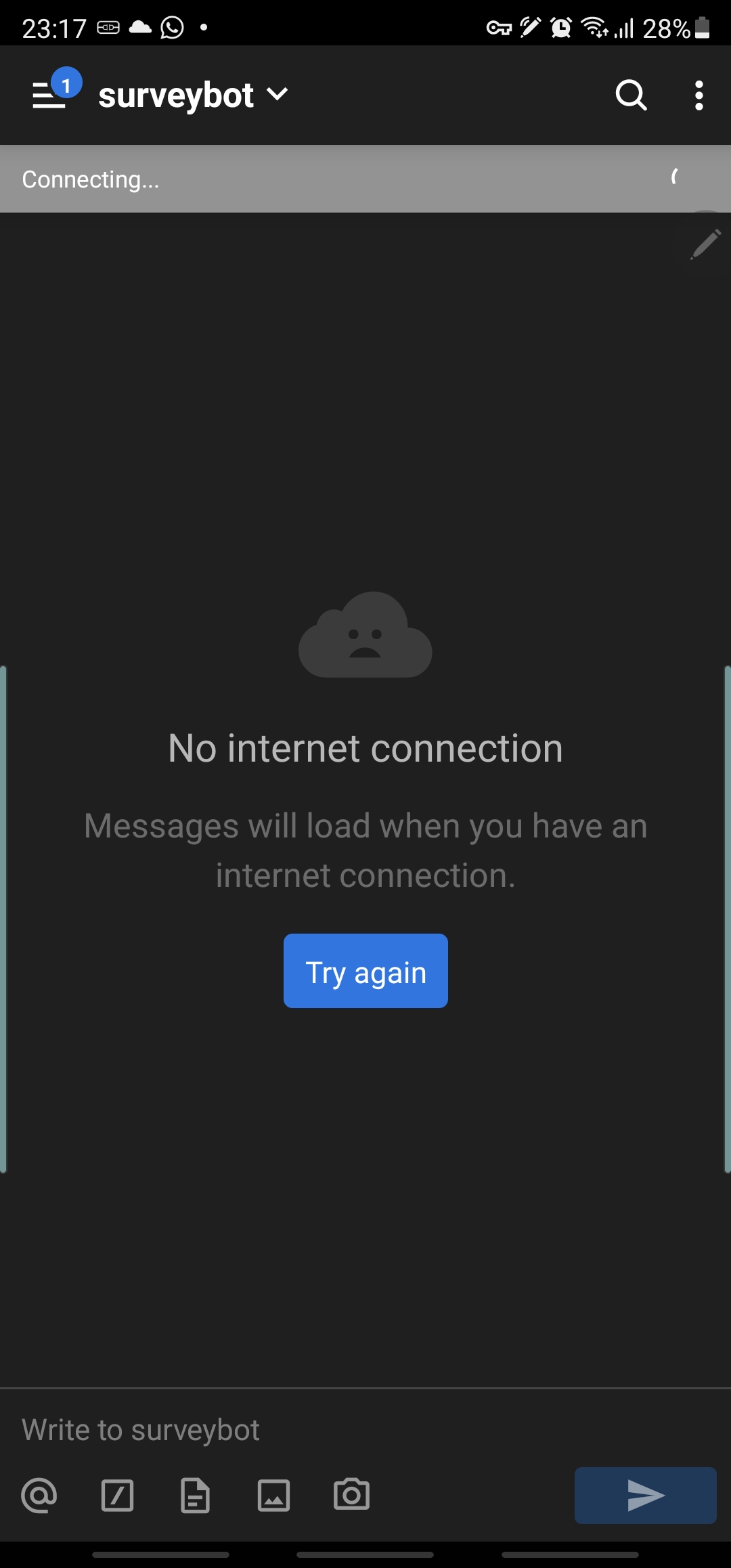

Unable to connect to MM server when connect to OpenVPN hosted on the router.
Steps to reproduce
MM Server Version 5.37.0 (happened with past versions as well), All mobile (v 1.45.1) and desktop clients
How can we reproduce the issue (what version are you using?)
OpenVPN is hosted on router, Ubiquiti USG Pro 4. Connect to OpenVPN, try to connect to MM on server behind router. It doesn’t connect. Disconnect OpenVPN, MM connects. MM is exposed to Internet and works on a normal network.
Expected behavior
MM should connect as usual when not connected to OpenVPN
Observed behavior
What did you see happen? Please include relevant error messages and/or screenshots.
MM shows connecting… At the top and no Internet on the main screen
I’m able to connect to all other local network resources and internet, only MM doesn’t connect.
