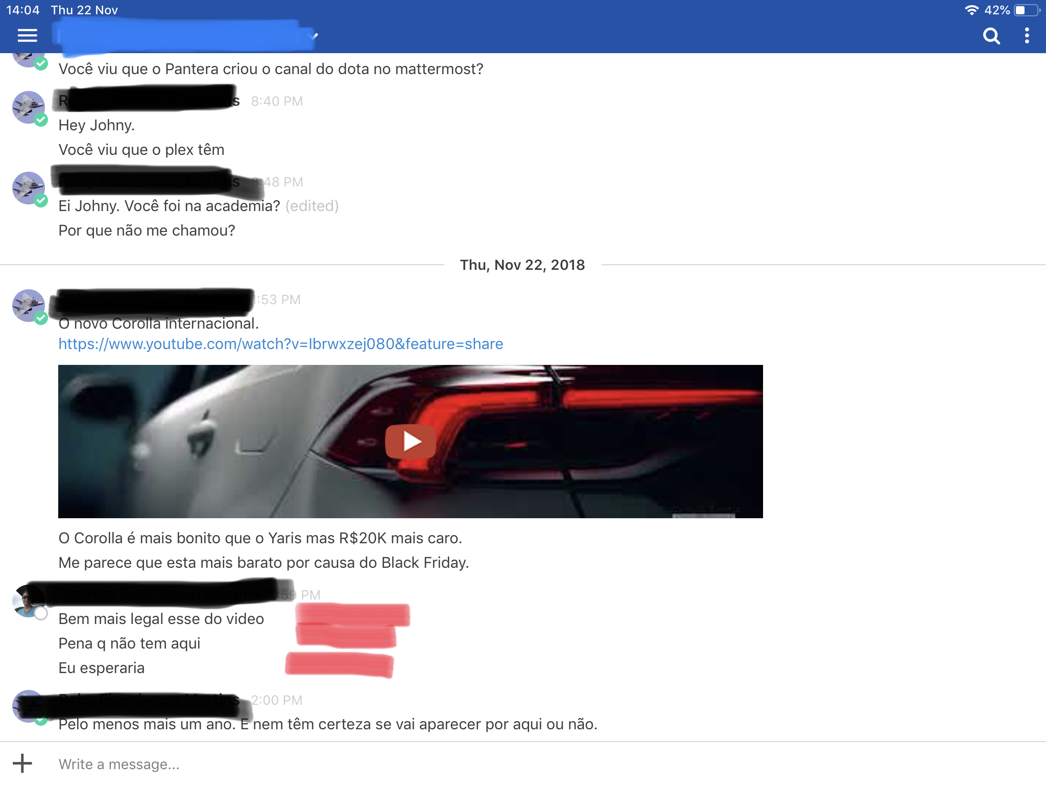

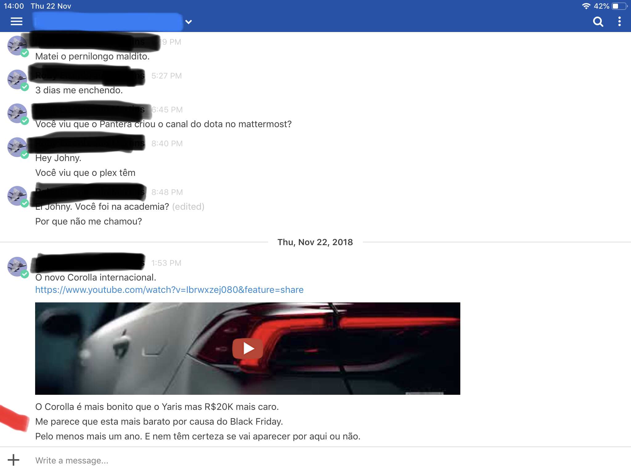

Another scenario with missing messages.
iPad:
iPhone:
